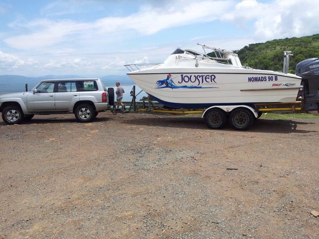

I dont want to hi-jack the thread, but you may find this interesting.
I tow a 3ton boat&trailer (plus full load = add another approx 600-800kg fuel and provisions etc) to ponta do ouro and back a couple of times year, and I dont think there are many examples of heavier work for the auto-gearbox. The vehicle really has to work over the hot sandy dunes once past the border. Although I never seen the engine temp gauge rise more than a needle width, I was worried about the temp in the gbox, as high temp and auto bxes are not complimentary to long life. So, I set up a temp measuring instrument directly at the gbox and have real time temps at my dash. I have been monitoring my gearbox temps for approx two years now. My intention was to never let the box get to 100degC, so in order to cater for a little instrument error, I actually will not let the gauge read over 90deg to be safe (not my intention to one day fork out for a new gbox as I believe they are fairly expensive).
What I have found is that normal operating temp (not towing) is between 70-75deg. When I tow with some reasonabe caution (90-100kmph) the box gets to between80-85deg, but if I drive hard, ie kicking down to lower gears and high revs, it starts to climb to 90 and would possibly go well above if I let it.
On the sand dunes I have to drive hard in some places over the approx 15km stretch to Ponta, but I have never seen the temp above 90deg - to me this means that the additional cooling system, ie front radiator, really does its job (some earlier posts on this thread talk about isolating the gbox radiator - I think that would be a big mistake!
