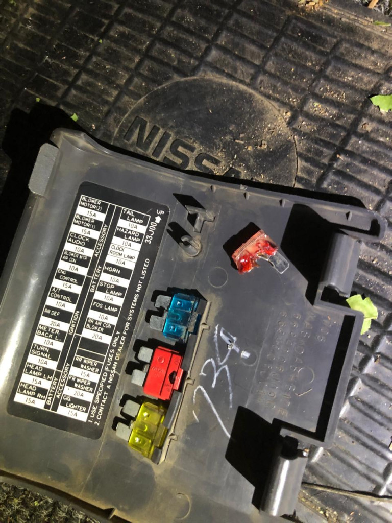

discovered a burned fuse. (clock audio)
Still a piece of the fuse stuck in there... :doh:
