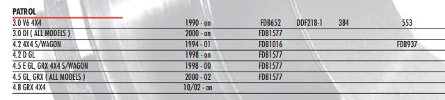

I'm now also wondering about which ferrodo part number is correct for the Y60...
Found this on a ferrodo brochure:
FDB937 for rear, fdb1016 for front.

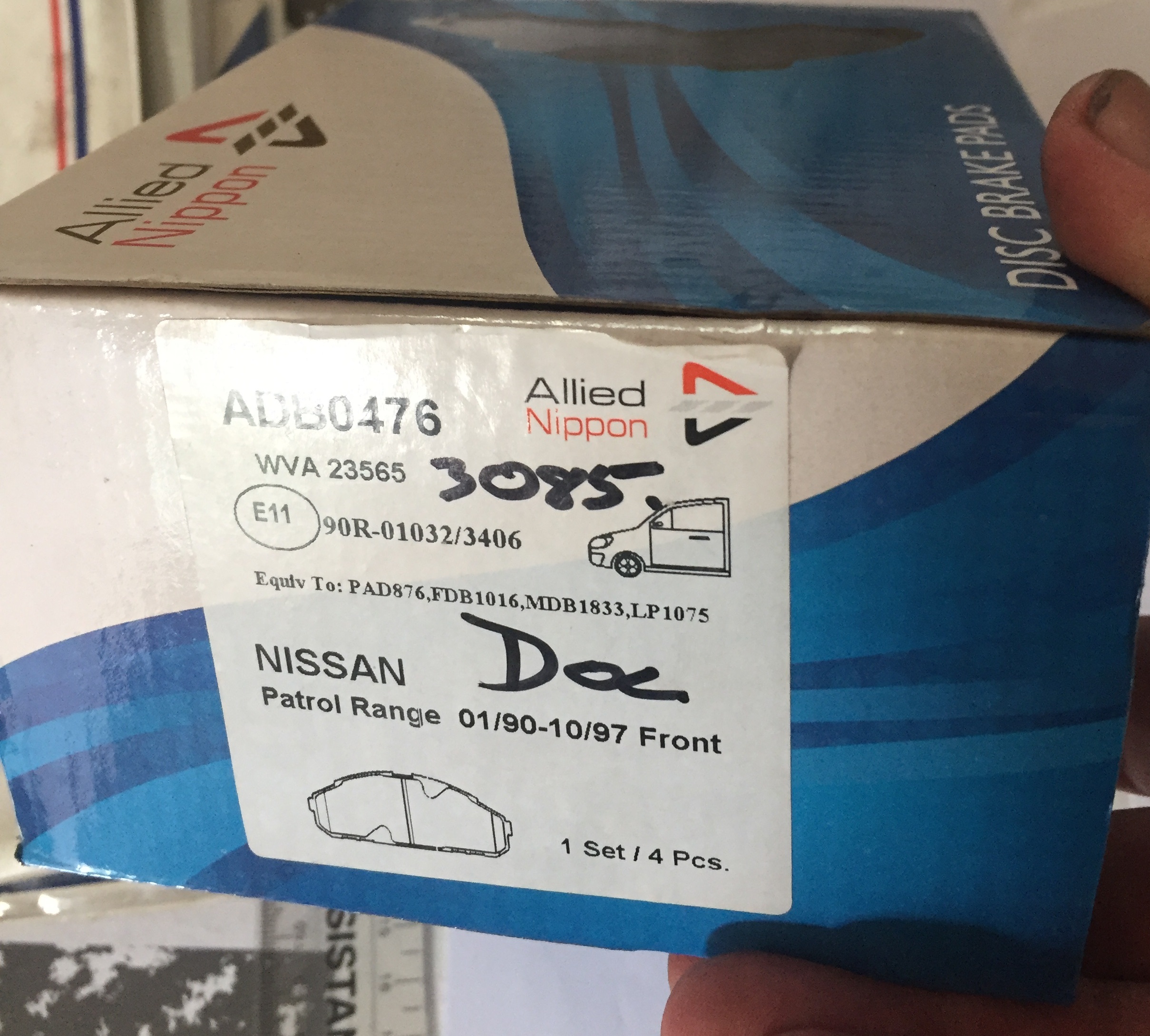

Seems that the Ferrodo fdb1016 is the correct pad for the 4.2 SGL and not the fdb643... (Could be that all y60's use the same front pads but I can not confirm?)
The Safeline D945 I bought is suppose to be exact same specs as Ferrodo fdb643, but they are too small....
Swapped them for Allied Nippon adb0476
(wil post pics shortly).

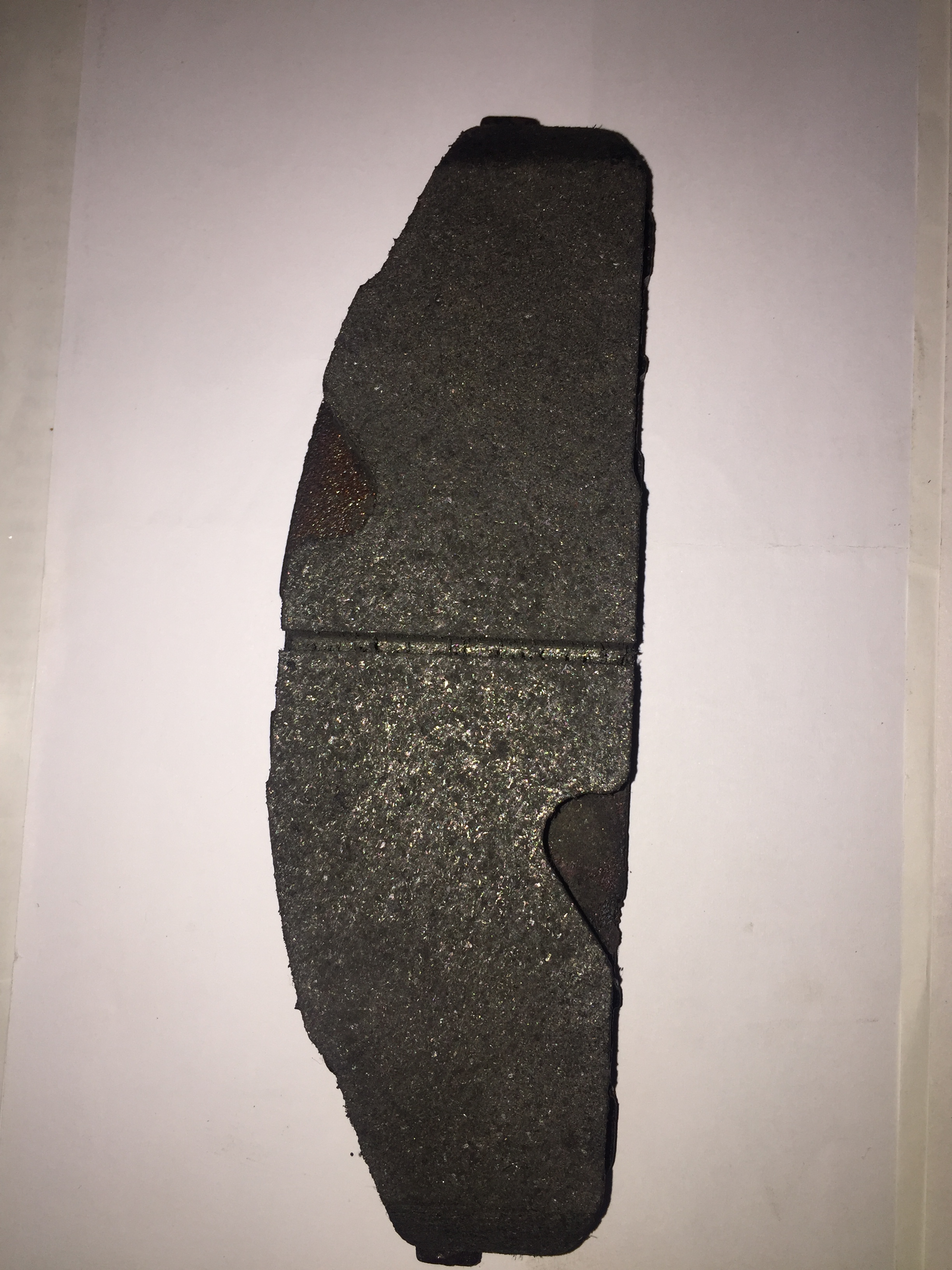

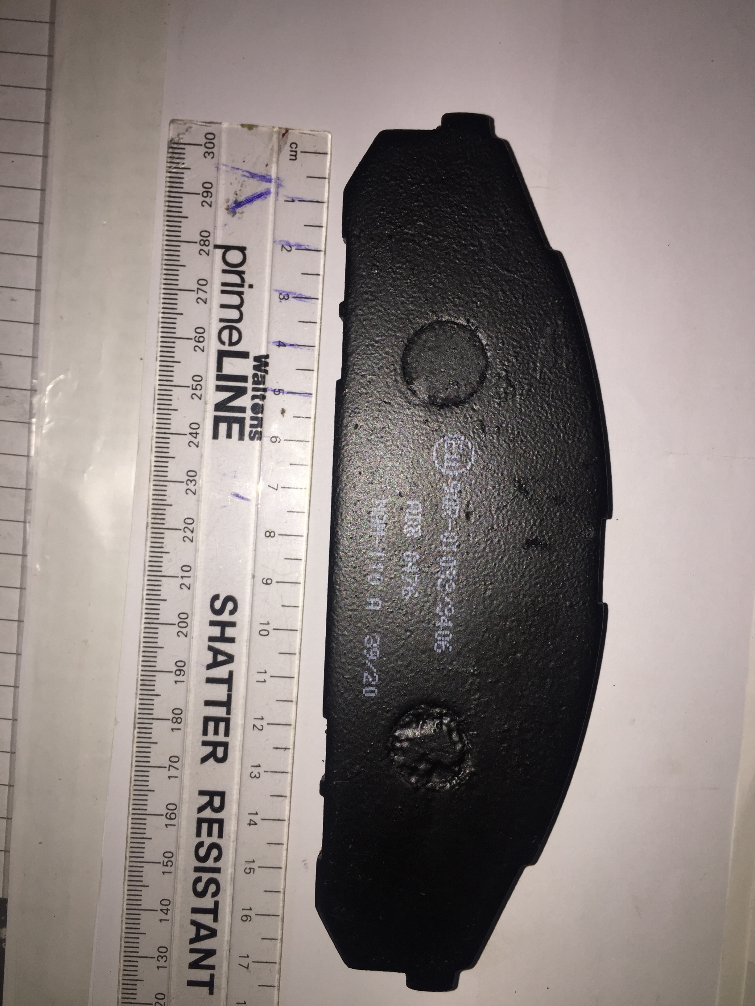

Hope they will fit...
I got about 4-5mm left on the current pads.

Can any GQ owners confirm if this look like the correct front pad?
