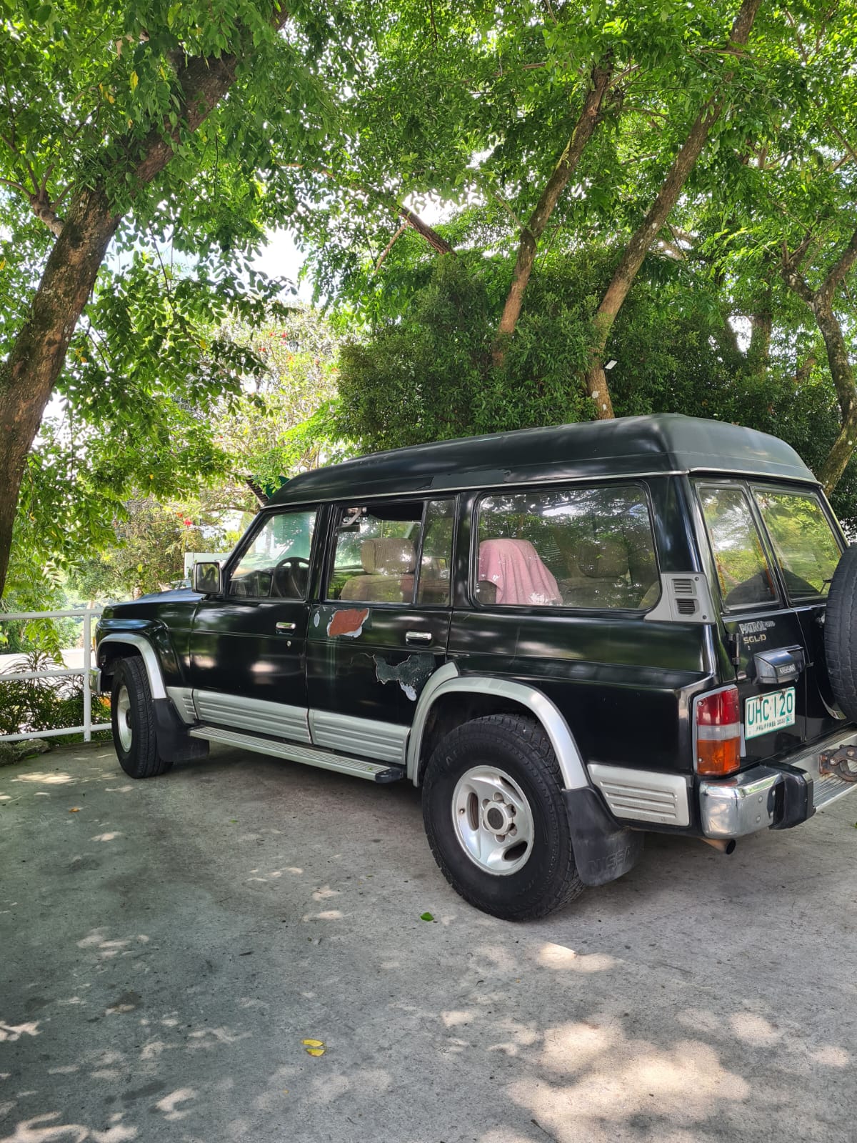

gChild wrote: ↑01 May 2022 04:18 Got it.
Took a trip to lake taal. Worked well. Couldn't make it up steep grade (14deg) paved road in 2wd. Dropped in 4low, second gear@ 2k rpm and boom climbed easily.
Shes need some attention but all hoses, belts, fluids and tires are good.
Trying to sort the headlamps. The battery was bouncing around so i strapped it with some wire. In the process knicked the bat terminal and sparks flew. Then the headlamps were not working. The side lamp turned on. I checked the following:
-bulbs ok
-fuse in car for headlamp 1and2 ok
-fuse link in engine brown ok
I'm thinking its the illumination switch or i shorted the wires. Any thoughts.
G
