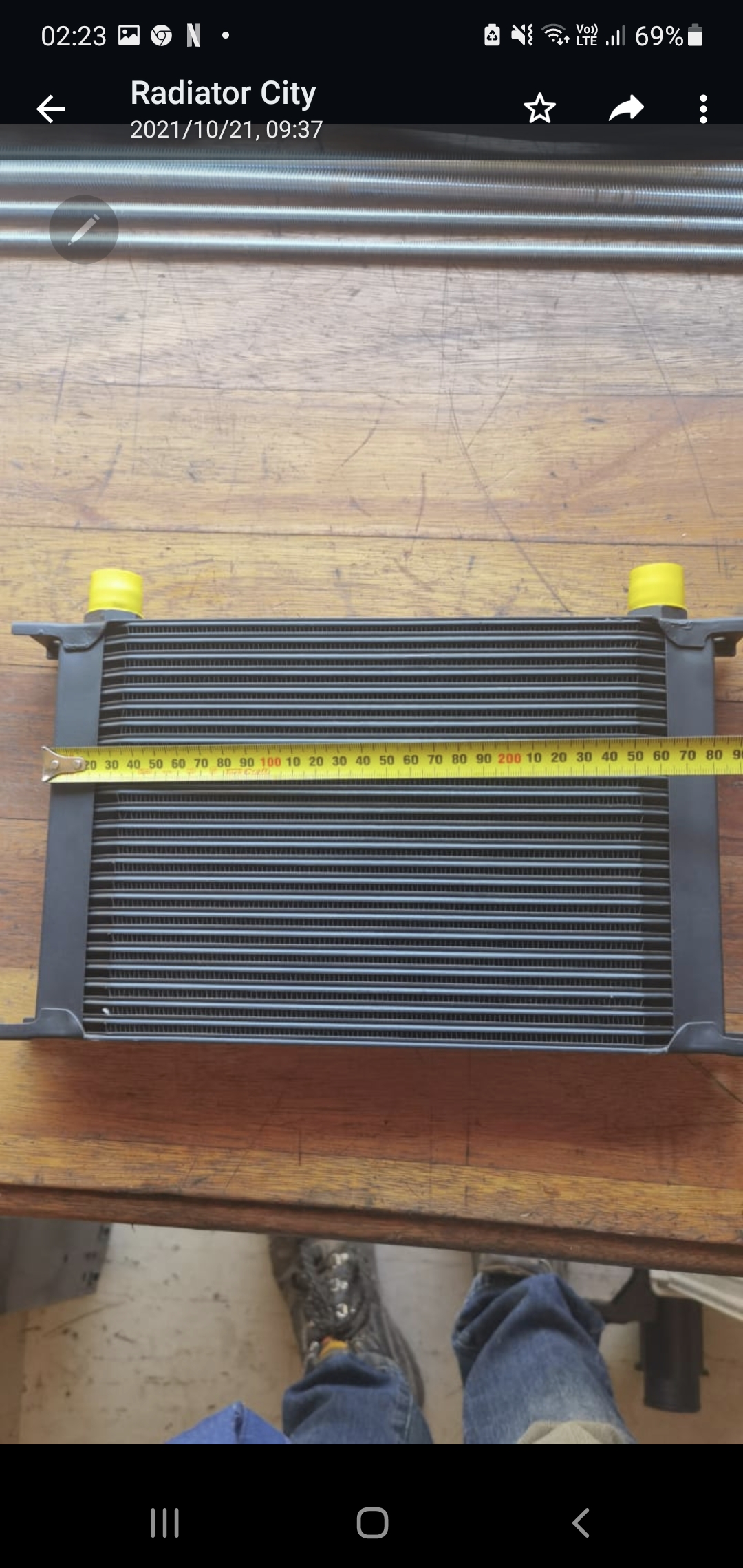

oil cooler plans on the TD42t
Engines and Engine Systems
Re: oil cooler plans on the TD42t

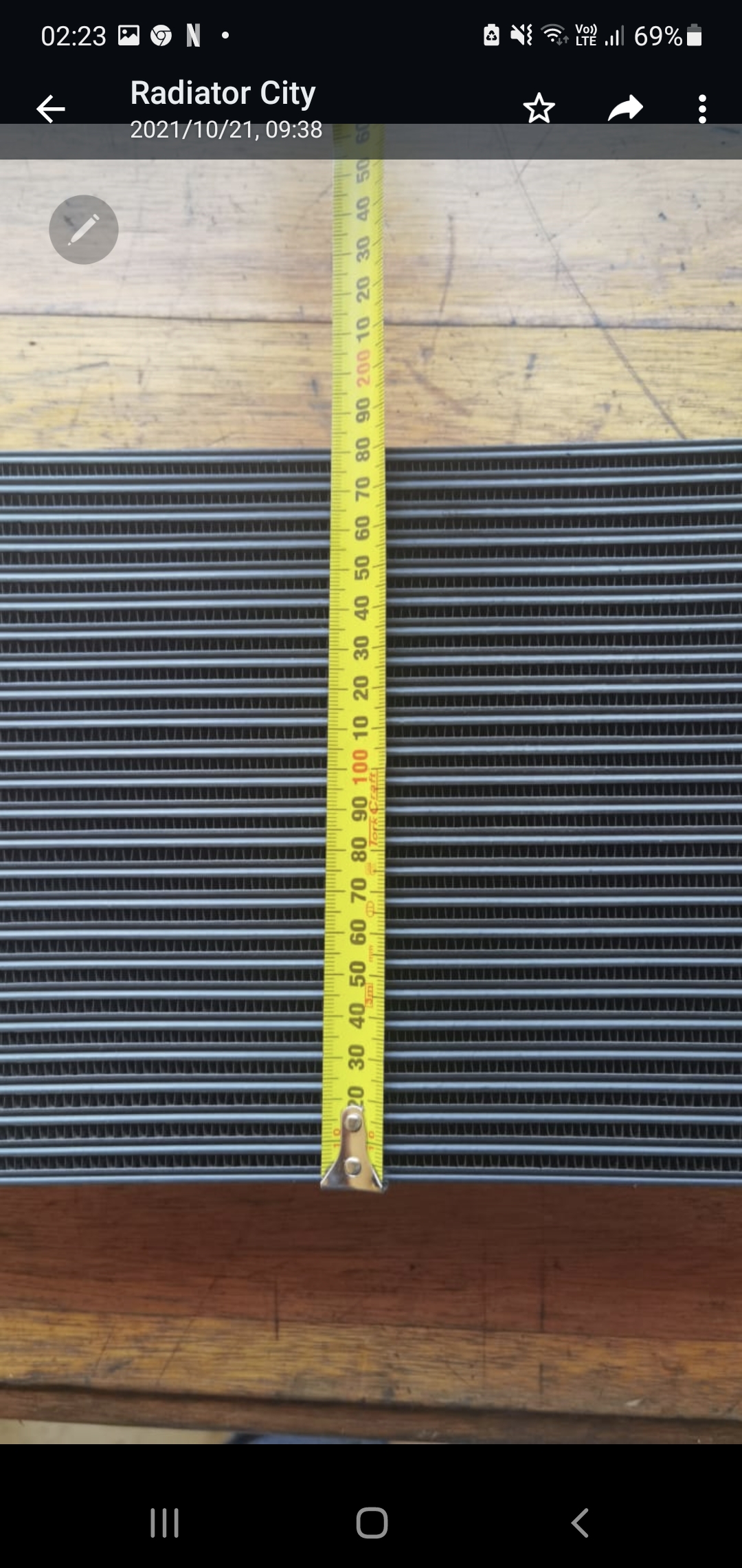

this cooler will fit properly in the corner section of the bumpers behind corner lights .so lets see what plans is going to work

that is what i dont want . its also the reason why the tread was started . Tijmen setup is like that and he can give us his experience with it .
iam going to give mr Connan a oil cooler and then we are going to see what can work without after market adaptors but please give me your plans and findings
