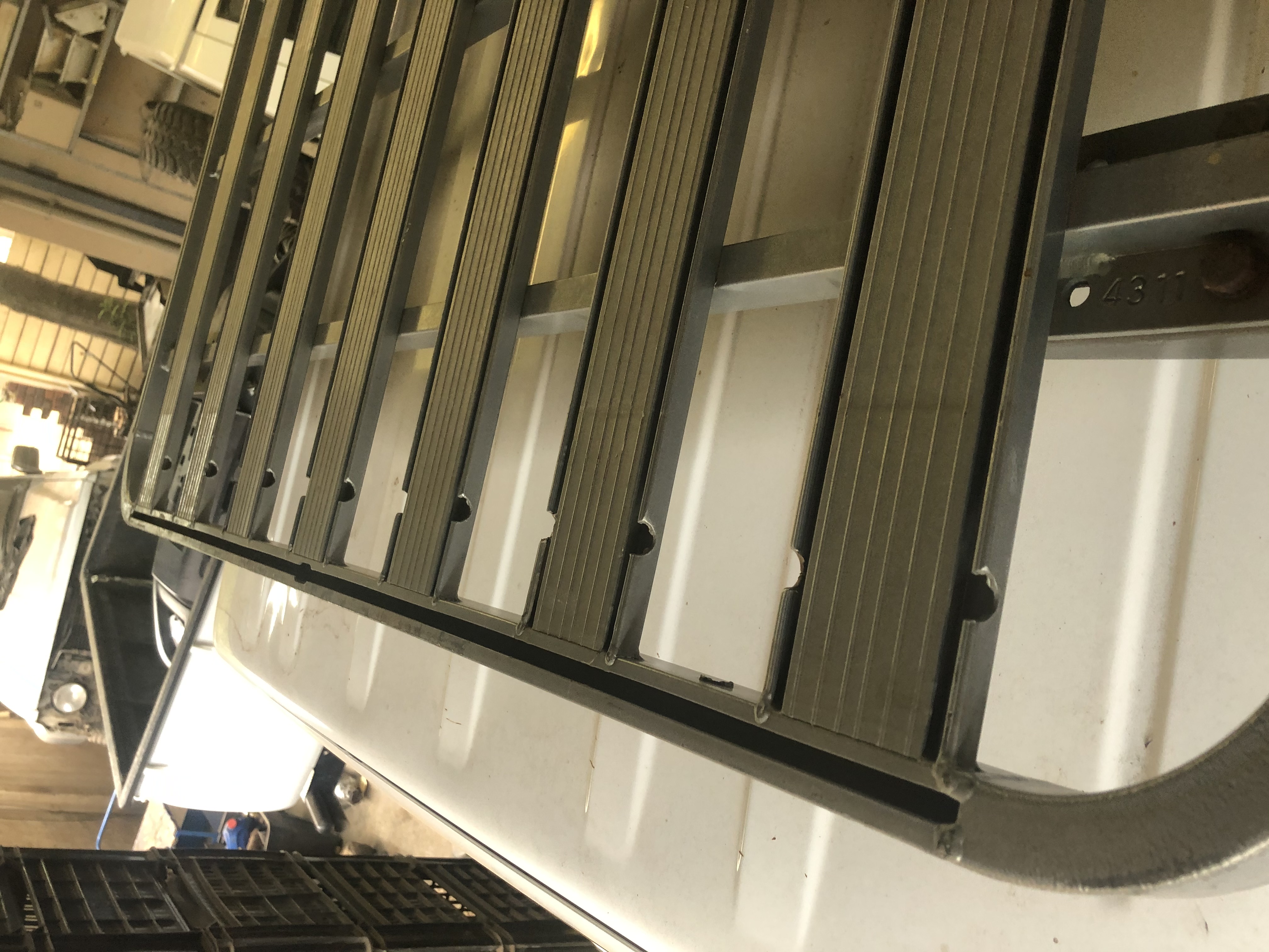

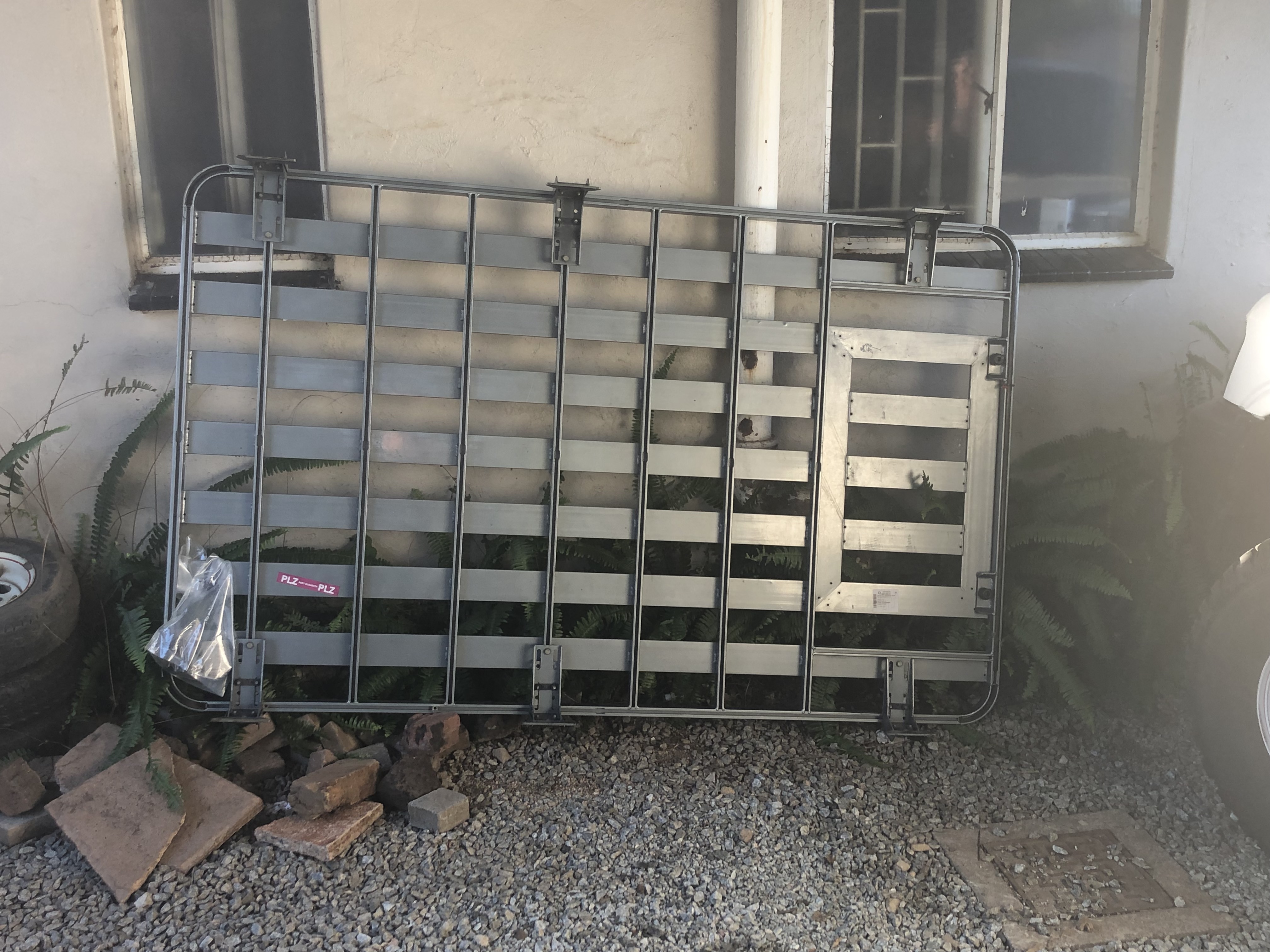

So after a lot of research and all of your awesome recommendations, I have gone with African Outback and here's why.
- Not one seriously bad review
- Any Negative feedback resulted in a replacement or repaint / re-spray at R0 cost: Based on various forums
- Weight of rack is the lightest and the widest (more surface area)
- They can customize it for you at a additional fee (Finishing, rails etc.)
- Compatible with generic accessories
- I prefer the vertical slats running with the vehicle as apposed to horizontally across the wind

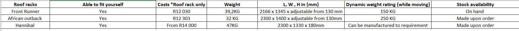

Summary of research below:
Links where to buy
Front Runner: https://www.frontrunneroutfitters.com/en/za/
African outback: https://www.bigcountry.co.za/
Hannibal: http://www.hannibal.co.za/
Did you know: Patrol model depending (refer SUV / Wagon), you should not exceed 100 - 120 kg, inclusive of the weight of your roof rack while driving / Dynamic roof weight limit...
I'm purchasing the rack through Safari N1 Center. They are charging me R650 for delivery and R647 for fitment, total cost of R13 600 inclusive
Only negative is waiting 5 weeks for it now
