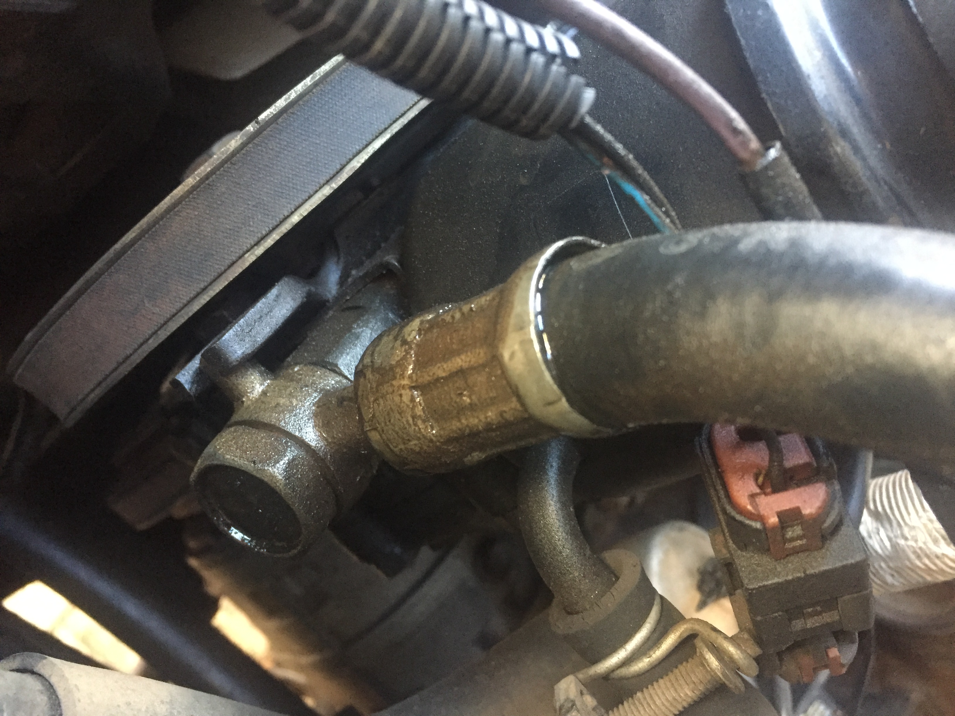

Re: Power-steering fluid leak
Mine is leaking on this pipe...can it be fixed? Or just replace pipe?
- Posts: 6157
- Has thanked: 1134 times
- Been thanked: 1044 times
Take the hose to a hydraulic hose supplier.
They can replace the rubber and the crimp fittings.
