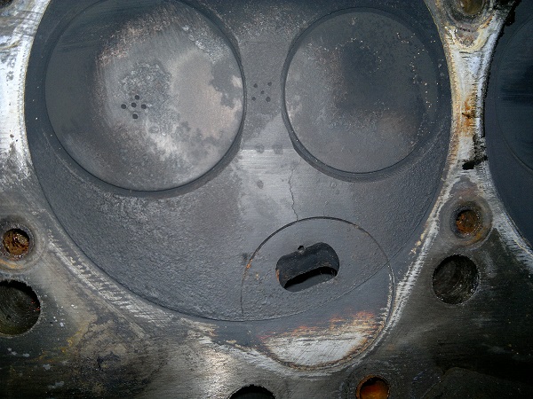

I don't think the precoms can drop as they are kind of half wedged in between the block and the head. Even if they were loose, which I doubt can happen ( but I may be wrong ....I'm no expert ) as they are reasonably tight fitting in the head and heat wise I would have thought that they expand more or less the same, and stay in place. It will be interesting to see when the motor is opened up.
Here is a pic of my aftermarket head where it cracked due to blocked water ports. See the precoms position ....
