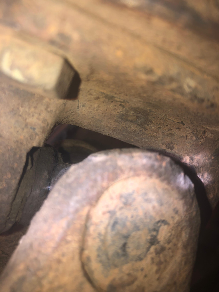

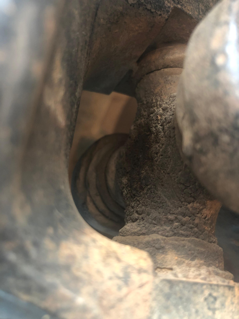

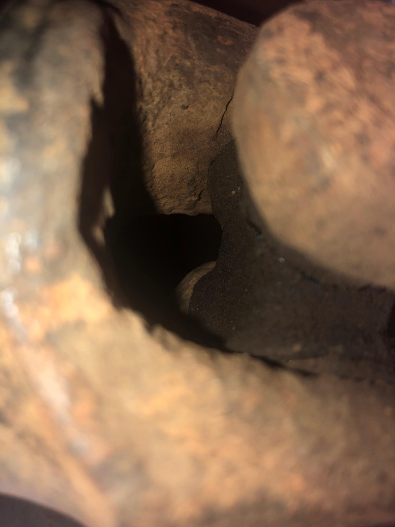

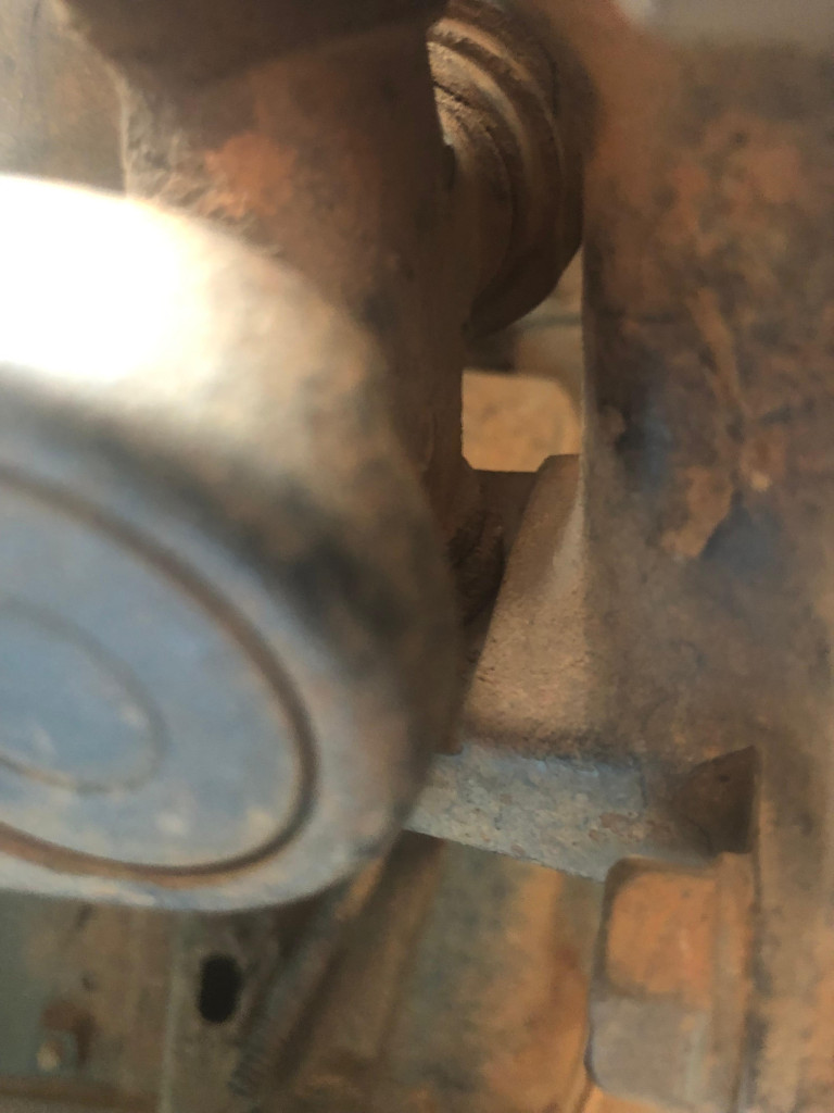

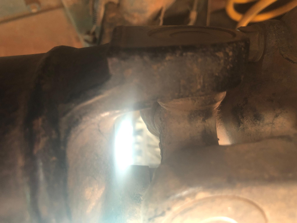

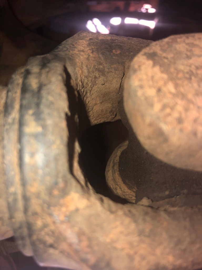

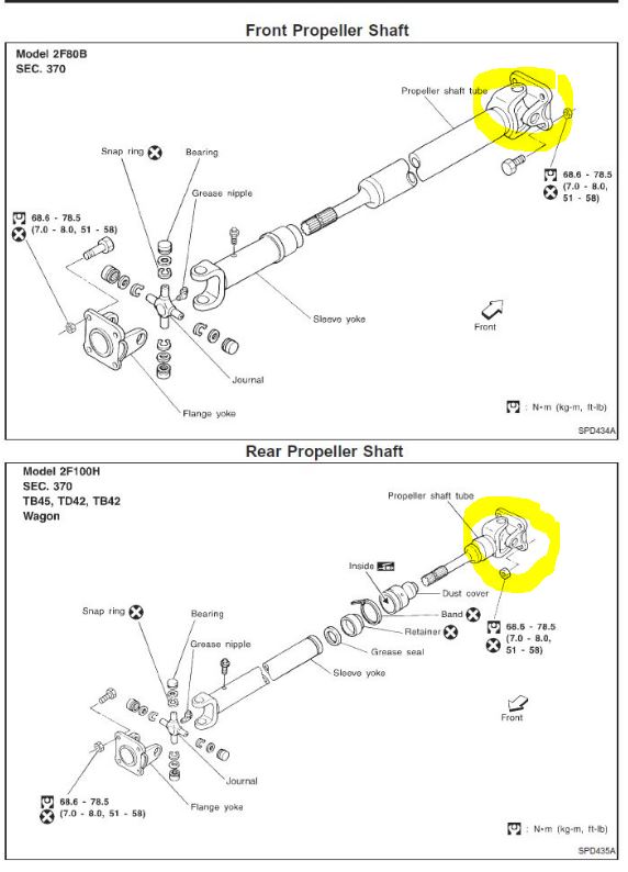

Re: Lubrication Points On 4.8 When Servicing
Just double checked mine, definitely no grease nipples in the two uni's marked in yellow...
