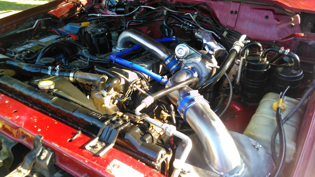

OK, so ek het vandag my kar by Michael gaan haal...
1. :salute: great job, baie netjies!
2. Low down grunt, kom dit veral agter in derde rat, waar die NA net daai bietjie gekort het. Handig in die stadsverkeer! :wink: en natuurlik in die veld, maar dit was in elk geval nooit 'n issue nie, dis net 'n ekstra bonus!
3. Oop pad. Dit was die issue - Vandag huil die wind oor die vlaktes. Met die NA het ek maar gesukkel in sulke weer. Ek sou tipies met so 'n sterk dwarswind 90-110km/h gehaal het, redelik gereeld in 4de. Vandag was dit 110-120 al die pad, in 5de. Soos ek aan Tinus laat weet het (dankie vir die tip oor die Madman!): dis die EGT en nie die throtle wat my nou briek.
4. EGTs - Slegs een keer oor 600 gegaan, 120 teen 'n bult op. Ek het uiteindelik op 110 gesettle met lekker spasie onder my regter voetpedaal, en heerlik gecruise! EGTs meestal onder 550.
Ek vertel anderdag weer. Maar vir eers, baie HAPPY, groot sukses. Thanks Michael, jy's 'n yster en 'n man van jou woord mater! :thumbup:

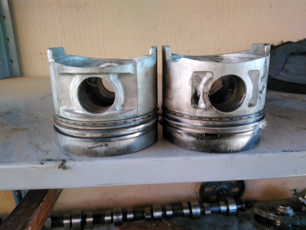

Christoph, really happy that you are pleased with the result.
Just to add a little bit more info on what was done.
This conversion was just aimed to get his Patrol out of "donkey mode". The engine is in a really good condition and after a compression test and noticing the very elusive silvertop pistons I think the engine will give him many happy km.
There are still quite a bit more power to mine out of the engine, but as decided before we started it was just going to be a "bolt on" to keep the costs low.
Next very import thing to do is the diesel pump as most of the power is delivered from there. If it is callibrated properly and the timing advance is set correctly it will be a totally different drive.
Geniet hom Christoph!

Go for it! With mine, we also sorted a few other little things out, like radiator (which wasn't done properly in Lichtenburg), injectors ("clogged up"), engine mounting, etc. All important in the end. And then the MADMAN - don't know if you have one. It will take some getting used to, knowing exactly what goes on where in your engine. But, as they say: If you don't measure, you won't know!
Immediately I am wondering about the EGTs for the NA km's on the vehicle - we'll never know. And my other diesel turbo's for that matter. I suppose that's where the Inter-cooler and correct settings come in. So, this is something to consider; and obviously the limiting factor on a bolt-on. Hence the necessity. So, I will be driving with one eye on it - still to set the alarm on the EGT. Michael suggested 580, and that's what I'll do.
One thing I picked up is the enormous variance in readings depending on driving conditions and pedal control. Coolant temp will range from 75-95 C with the needle on the dash not moving a mm. Actually pretty cool gadget!
The driving experience - even with the bare minimum done, like mine, there is a more than subtle difference on the open road. You know that comfortable 'sweet spot' you reach when cruising on an open road? That's more readily available. (OK you petrol heads, don't laugh. You gotta be a smoke machine to get this! :rolling: )
Passing a truck: No more :helpsign: and rowing in your seat. It's by no means fast, but it accelerates! :woo:
And I believe that most places 5th will suffice. What I have realised though is that I shouldn't change my driving style (as in when it was a NA engine). Gear changes for example - still stay in 4th that little bit longer. Tinus explained this - more air from higher revs keeps the EGT down. I think that makes sense, if I understood him correctly.
And then, watch the EGT at the top-end.
Obviously it's early days, but my early expectations were met. I expect a little better fuel consumption, because I don't go voet-innie-hoek all the time. Will keep everyone posted. Also, as I drive it under varying conditions, I will realise just how big or small the difference for that condition is. Once again, will keep you posted from time to time.
After seeing the silver top piston design, and chatting to Michael about the low pressure set-up, and taking into consideration the excellent condition of the motor (now this is just 'Genade! Baie dankbaar...' - sorry no English here), and provided I keep it in good nick, I am confident that this engine will last a long time!

turbo setup
'n Patrol kan sluk! - onder andere 2 x 3m kajak
Standaard piston vs Silwertop

That motor is looking GREAT Chis :thumbup:
