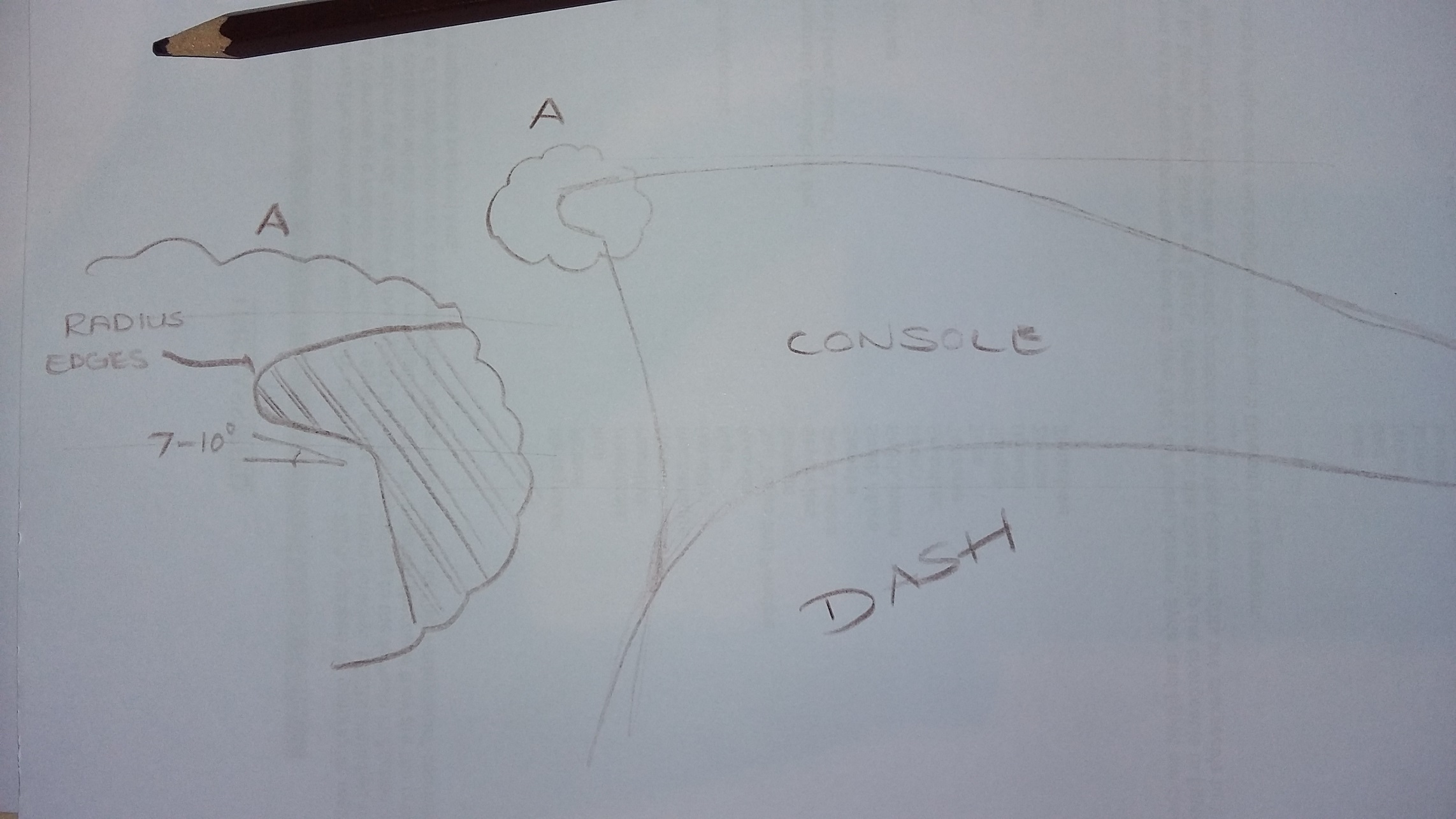

I wanted to do a decent sketch or quick 3D model for illustration purposes, but to be honest, I'm just too tired and gatvol to make the effort right now. So I apologize in advance :lol:
I'm too lazy to go find my technical pen set and graph paper, so the back of a statement and my daughter's blunt brown pencil is all I can muster at this point. Never mind the fact that I'm a lefty to make matters worse :biggrin:
You need to ensure the leading edges of the lip are tapered slightly and a slight radius added to avoid any fouling when delaminating the part.
Rough sketch.jpg (485.8 KiB) Viewed 4945 times

@ Dustin.... That lip on the front of the console was where my plaster original plug had its biggest issue. There was a slight taper, but I doubt enough, as 95% of the lip came out the mold perfectly but I battled at the curved end and that's where I had the failure.
Due to the rigidity of the plaster, I figured that the flexibility of the closed cell foam may be the answer to my dilemma. I cannot make the console any higher as it will then affect the line of site from the drivers sitting position, to the opposite corner of the bonnet. Its amazing how just 5mm extra height creates an obstruction of ones line of site, and due to us not being all of the same height .... well self explanatory i guess...haha.
If I thicken up the lip to allow a greater angle ( for release ) then I loose some height on the face where the gauges fix to. this in turn creates the problem that the gauges will not fit from the right hand side of the face towards the right hand side end, due the the curve of the GU dash shape. Also different manufacturers of gauges have different thicknesses of bezels which also has to be taken into account. This console can house comfortably 4 x round gauges and 1 x square EGT gauge ( like the Madman or MGL ). The face will be without any holes to allow whomever to fit either 1 to 5 round gauges or what ever variety of set ups. Ideally I would like it if one can fit the TPS monitor many guys have in there too, taking it out of the way of the also important dash cluster lights and gauges. Basically I want to make something that is hugely multi-functional and aesthetically pleasing to the eye, in other words an almost factory design finish.

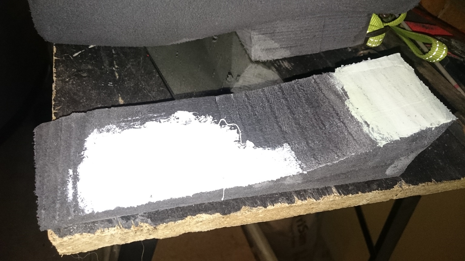

Ok... so I did a quick tester on an offcut piece of foam....very interesting results...
I coated a section with plain old cobra floor polish ( i know its not the best stuff but its all I have at the moment ) and it seems to settle well on the foam leaving a nice looking barrier. On another section ( unwaxed ) I put some body filler directly onto the foam. This seemed to adhere nicely to the foam. I then took some gelcoat and applied it to both treated (waxed) and the untreated section of the rubber and left it overnight to see the results.
After 14 hours the sample is in exactly the same condition as last night !! considering that the fibreglass resin will not be in direct contact with the foam I didn't put any on as the gelcoat will be the barrier ( and the PVC mold release ). Here is a pic of my test sample.....
