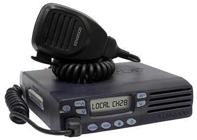

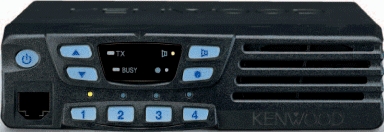

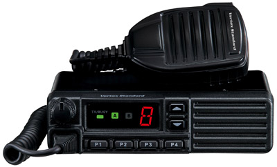

The popular VHF Radios are, in no particular order, as follows:
Kenwood TK7102, 4-Channel capable Kenwood TK7100, 64-channel capable Kirisun PT8000, 8-channel capable Vertex VX2100, 8-channel capable.
All these radios are of a like size and feature a front-mounted loudspeaker. Normally, the TK7102 is adequate for VHF comms, unless you wish to include other VHF frequencies such as the ORRA and (for example) the Land Cruiser Club if you have the required licences. The 64-channel TK7100 is really only useful if you also partake in the ORRU activities, where they prefer having various EMS frequencies programmed into the radio as well.
