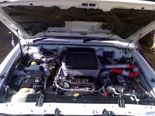

hmmmm.... air cleaner... now this will be fun....
The air filter on my Patrol is from a ZD30 ( 3.0 Patrol ). It is a tight fit to say the least, as I have my dual battery in the engine bay too. Christo ( Chuck ) has a Donaldson cyclone filter box fitted if I recall correctly. The air filter for the ZD30 is available from GUD... believe it or not, it'a a Mann & Hummel filter in Mann & Hummel box....with a GUD sticker on... :surprised: and is not expensive ( cant recall he price off hand), but obviously the Donaldson will have a good filter too, and their prices are very reasonable too.

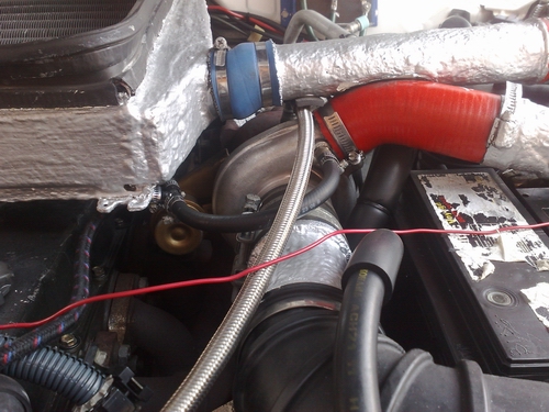

That red silicone air intake pipe from the turbo to the intercooler ( I/C) was a %$@# job so I had some stainless steel bends welded up and wrapped in heat resistant tape to get a smooth airflow into the intercooler.
Firstly you need to decide where your turbo is going to be mounted. Again Christo for example has his turbo fitted quite low down in the engine bay. Mine is fitted quite high up in the engine bay
There is varied opinions on the placement of the turbo. Mine was already fitted when I bought it, but was told that the main reason for fitting it so high was to prevent cold water ( boat launching or water crossing ) from touching a VERY hot turbo.... make sense :think:

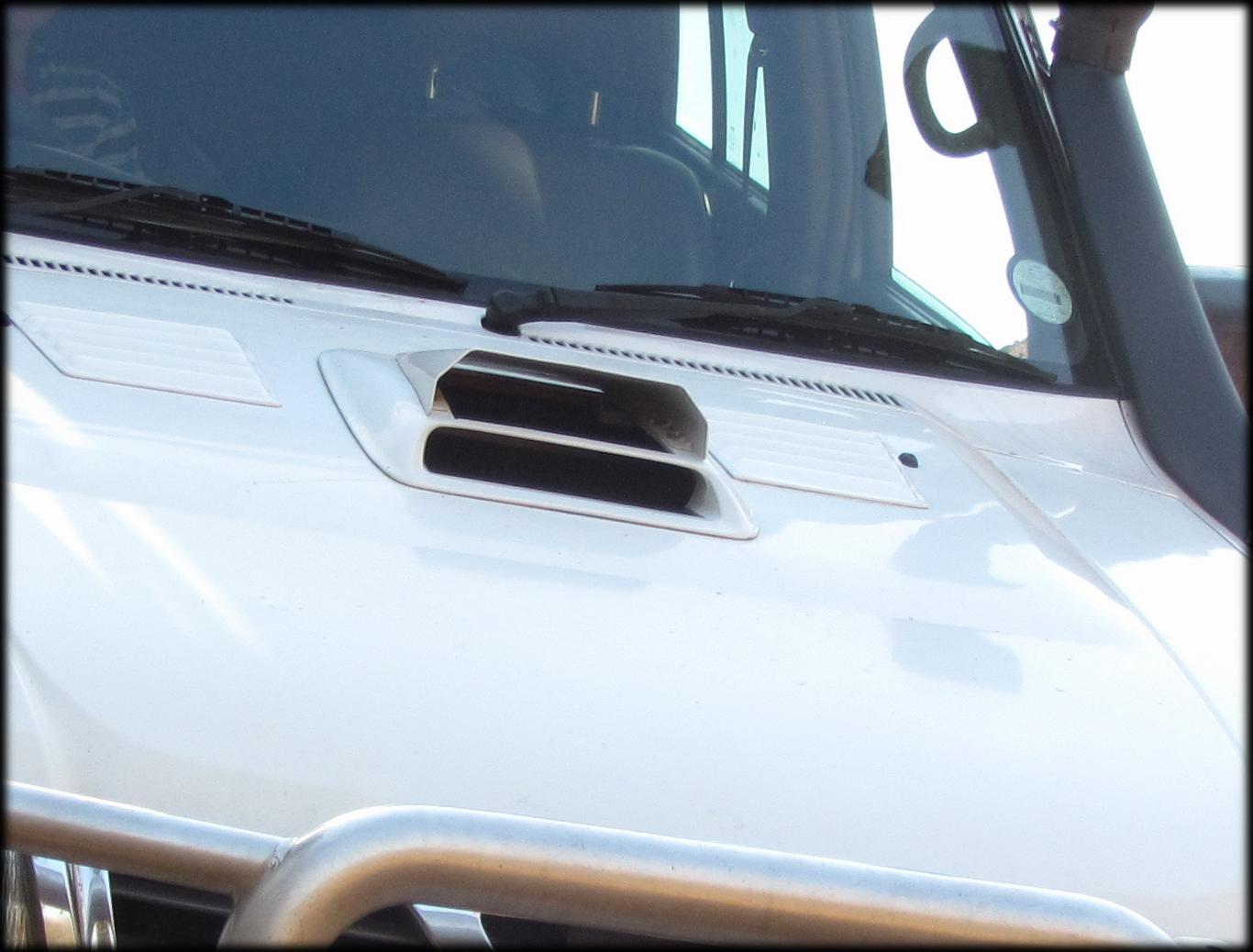

Then as for intercooler placement. I have no space in front as I have the an extra oil cooler radiator between the grill and all the other radiators. I think this way will be the most efficient as cool air is rammed into it. They fitted mine on top. Mine is a rather big intercooler if I look at some other 4.2's intercoolers. This can be a problem..... if you have an aftermarket bull bar fitted that has a cross member in line with the bonnet, the air flow will be disrupted from flowing over the bonnet, and being scooped into the intercooler by the cowling. So you will need a powerful high volume electric fan to be fitted. The fan would be switched on either by the ignition switch or via a hand switch in the vehicle, or via both ( to prevent constantly running when not needed. I did an extra mod on my I/C by doubling the air intake area of the scoop. This made a HUGE difference, at least a 30-40 deg temp drop on pre turbo EGT's.
So piping is easy for a top mount, but there are extra expenses.
